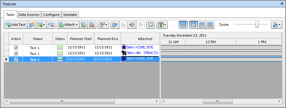

Attach Tasks to Geometry
Each task needs to be attached to items in the model before simulation can work. You can create and attach tasks at the same time, or you can create all tasks first, and then attach them, either separately, or in rule-defined batches.
Tasks can be attached to the current selection in the Scene View, or any of the selection sets, or any of the search sets. You can also drag and drop items from the Scene View, Sets window, and Selection Tree directly onto a task. You can view the type of attachments in the Attached column. By default, this column is located after Task Type, but you can move it, for example, in front of the Start column.
