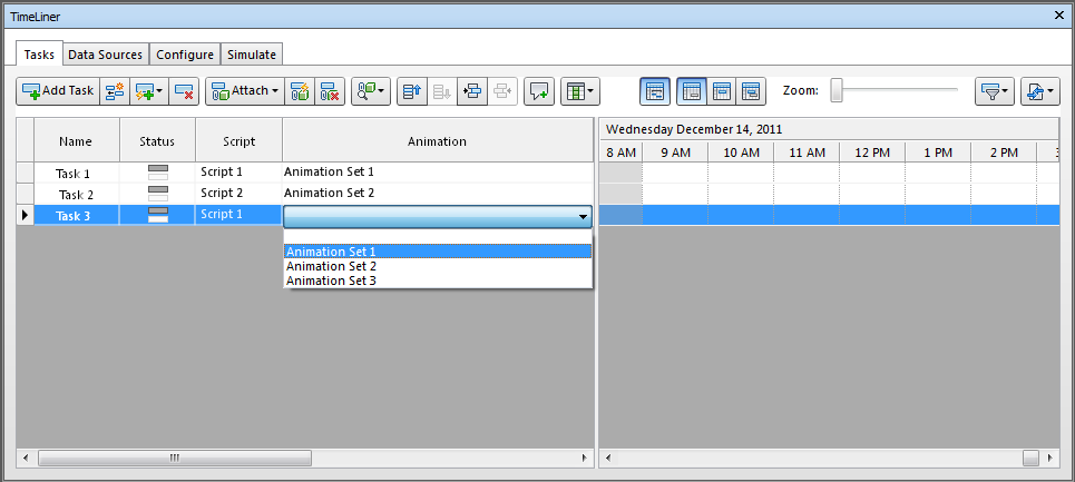

.On the Tasks tab, click the task you want to add an animation to, and use the horizontal scroll bar to locate the Animation column.
If you prefer, you can move the animation columns in front of the Start Date column as shown below:
Click the drop-down arrow in the Animation field, and select a scene or an animation set from a scene. When you select a scene, all animation sets recorded for this scene will be used.
