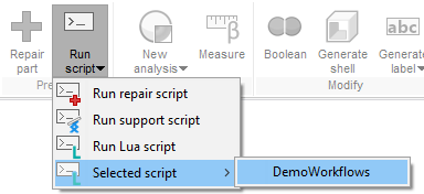

Desktop automation only: To make Lua scripts available for execution within Netfabb they are stored in a library, that means creating and editing, or loading them from files, and then storing them internally. The library resides in Netfabb's settings database. The library provides several functions:
- If running Lua scripts happens often during working with
Netfabb, set any script in the library to appear in a dropdown menu in the toolbar.
The icon in the toolbar makes Lua scripts readily available.

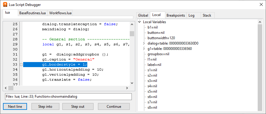

- The library provides a
Debugger to have a closer look at the operation of a script. You can run one line at a time, observe variables, set breakpoints to halt execution at specified steps, and observe output written for logging purposes.
Stepping through a script can help with identifying mistakes
