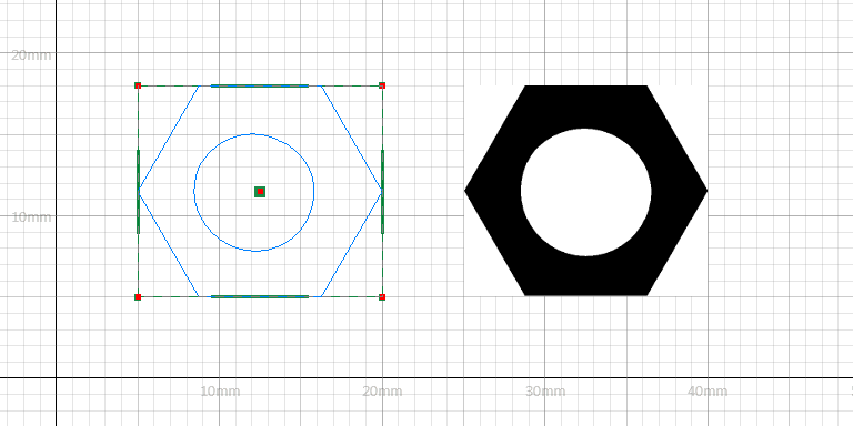

Any created slice images originate at the outbox corner of the part positioned closest towards -X and -Y, rather than at the slice display's origin. Any offset to the slice display's origin is ignored.
The 5-millimeter offset in the slice display is dropped in the exported images, inset on the right.
