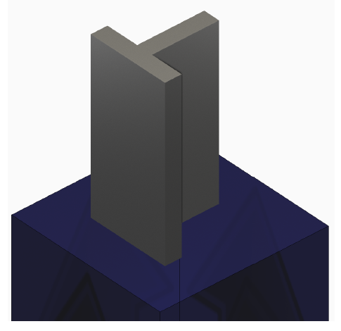

Figure 1: DED compensation example geometry

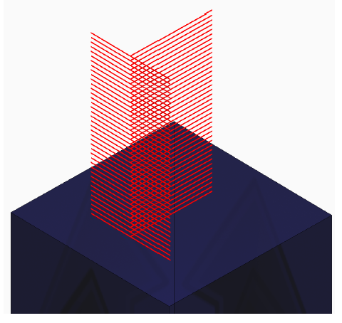

Figure 2: DED compensation example path

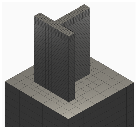

Figure 3: DED compensation example mesh
