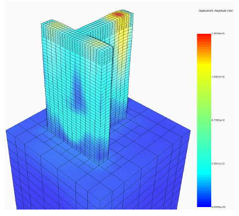

The results can be viewed in Simulation Utility for Netfabb or ParaView by importing the .case files. The post-process distortion is shown in Figure 4.
Figure 4: DED compensation distortion results

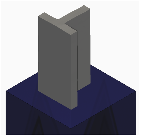

To create a compensated STL from the DED results, the input file for distort_stl has the *STLF card added to it, pointing at the nominal geometry STL. Execute the compensation from the command line:
$ distort_stl DEDCompWarp-1.in
The resulting compensated STL is shown in Figure 5.
Figure 5: Compensated geometry from a DED simulation
From this compensated geometry one can create a new laser path which, when printed, will reduce distortion in this part.
