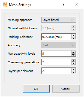

Specify the meshing approach, mesh density settings, and multiple STL padding tolerance.
The Padding Tolerance setting applies to both meshing approaches. It is used to fill gaps that may occur between part and support structure, or any situation where multiple geometries are in contact. If gaps appear along the interface after the geometries have been meshed, increase the padding tolerance value, and each STL file will be expanded in all directions by this amount. Keep this tolerance value as small as possible to maintain dimensional accuracy of the original geometry.
Layer based
This Meshing approach provides advanced users with direct control over the mesh by using the settings Coarsening generations and Layers per element.
Coarsening generations is the maximum allowable number of coarsening steps taken. Coarsening only applies to layers below the deposition layer. When coarsening is enabled, small elements are used to represent fine detail in critical areas, which is determined by the Layers per element control detailed below. Larger elements are used on the build plate and areas with lower detail requirements by combining smaller elements together, where the geometry allows. Typical settings are from 0 to 2. A setting of 1 is generally a good compromise between speed and accuracy. A value of 2 should be used only for large geometries that have large surface areas in the build plane, while also having fine features that need to be captured.
Layers per element represents the number of powder layers in the thinnest element of the part. The size of the smallest element is equal to Layers per element X the powder bed deposition thickness contained in the PRM file. More layers per element produce a coarser mesh, and faster run time. Fewer layers per element are needed to represent finer details, but both run time and memory usage may increase dramatically. It is recommended the lowest value used is 5.

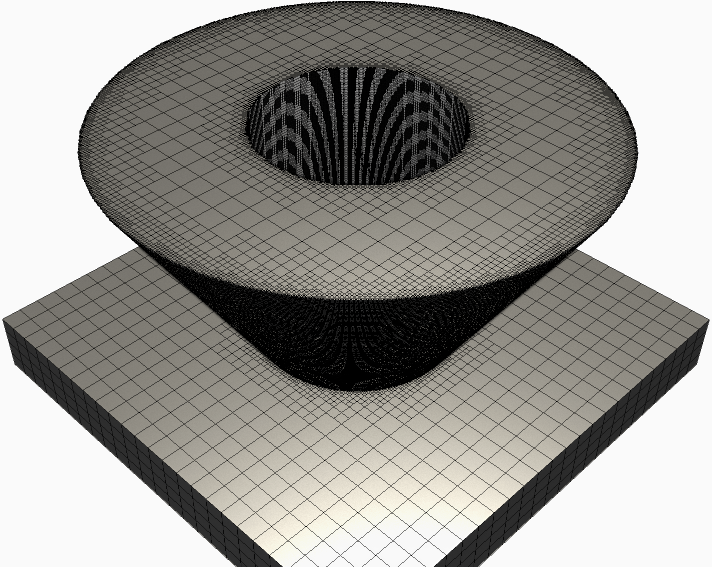

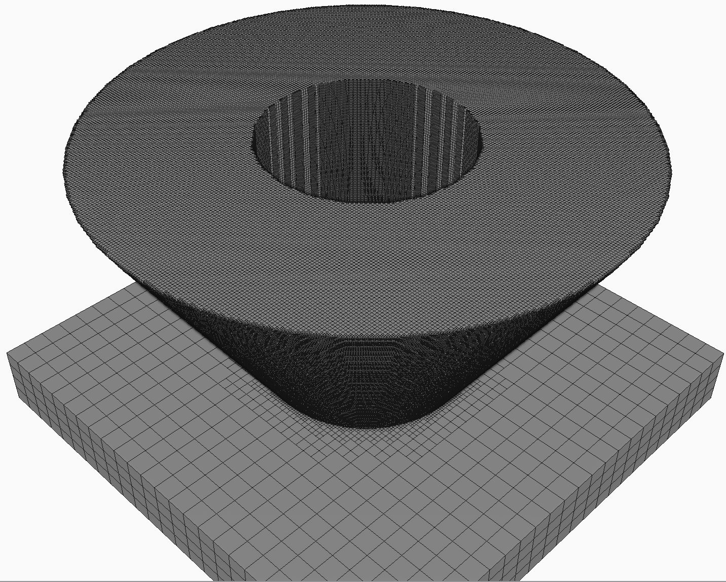

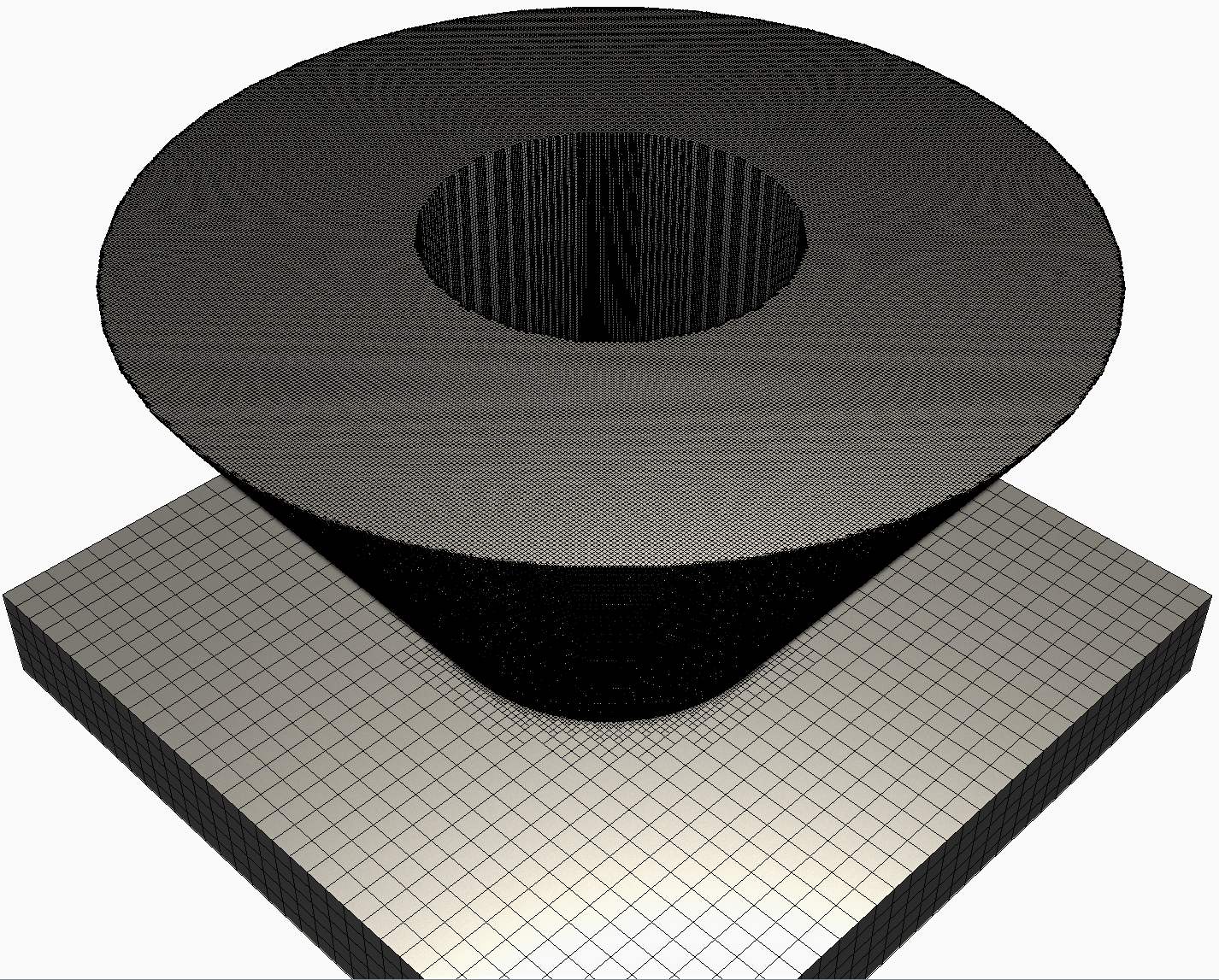

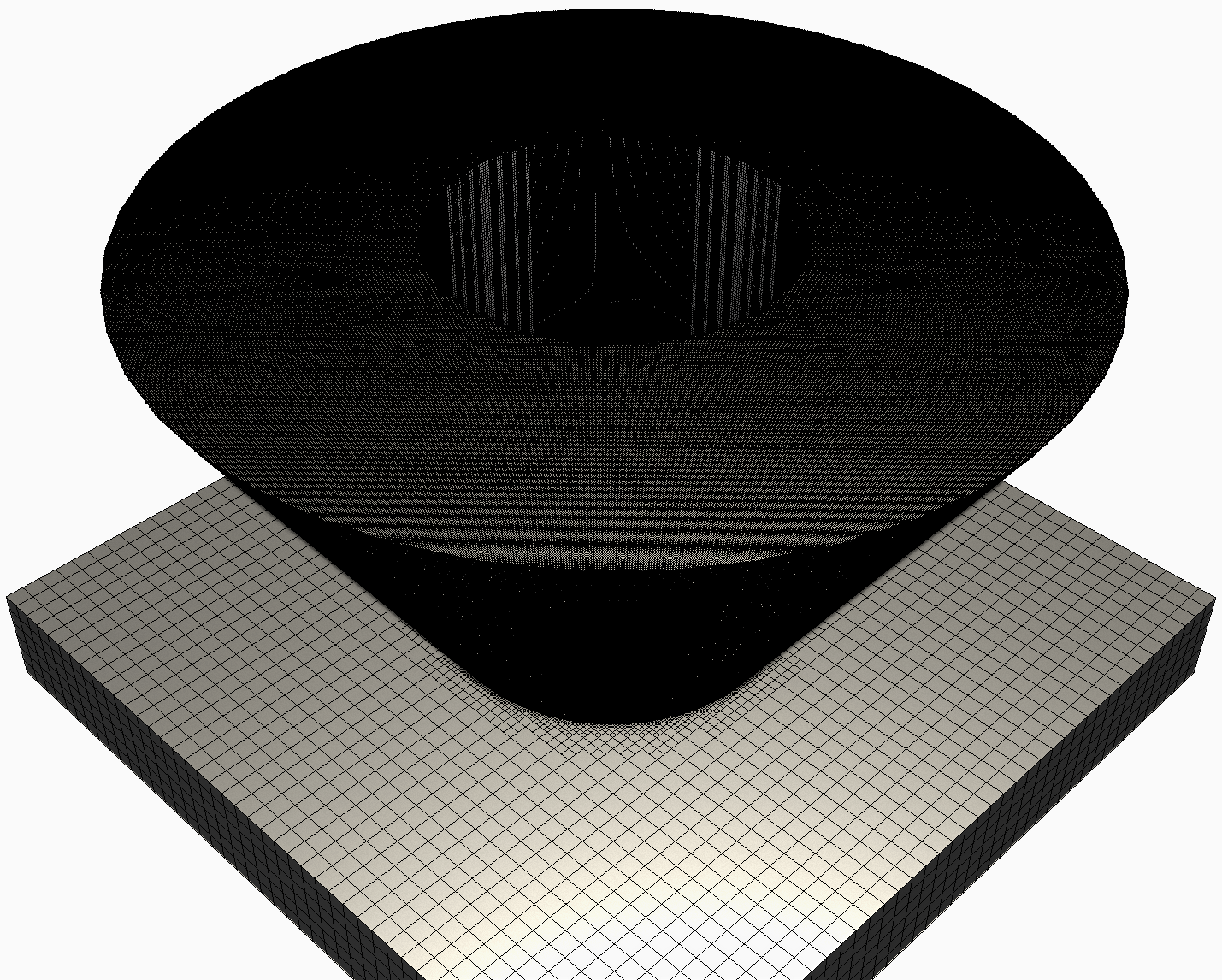

The results of the four meshing approaches for small geometry are shown below, with each mesh figure clipped around 90% of the maximum height of the part, to show the interior of the mesh, where coarsening is allowed:
| Fastest | Fast | Accurate | Most Accurate |
| 894468 Nodes | 894468 Nodes | 1824744 Nodes | 3621073 Nodes |
| 22361700 Elements | 460488 Elements | 971538 Elements | 1917649 Elements |
| 4430 s Projected run time | 7530 s Projected run time | 41900 s Projected run time | 207000 s Projected run time |

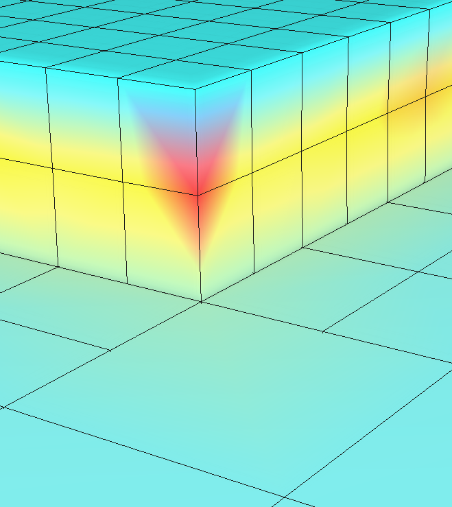

From time to time magenta or purple results may be observed in the results as in this figure:
This occurs whenever the range of the display result spans from the lowest to highest in a single element. This typically indicates that the mesh used is not fine enough for the simulation geometry and settings and that one should decrease the number of layers per element.
