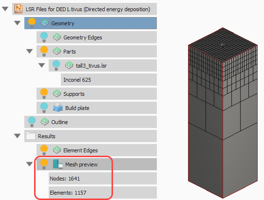

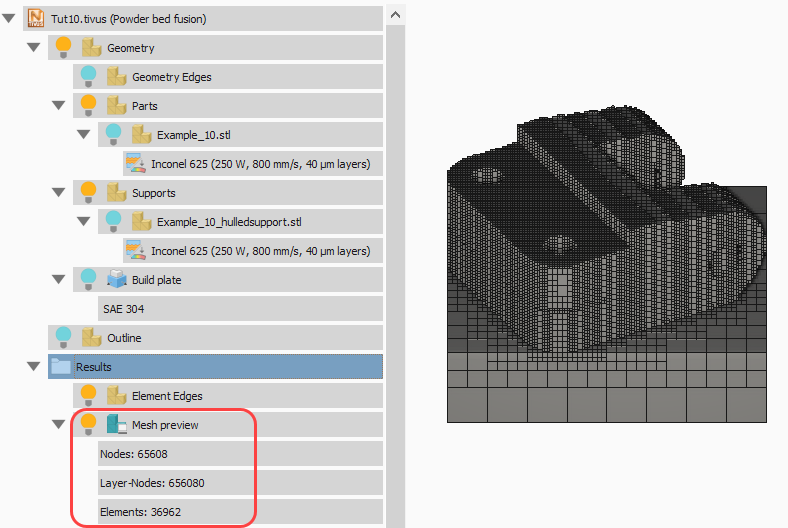

In the Browser, below the Mesh Preview icon, mesh metrics are shown for the number of Nodes and Elements, which can be used to estimate complexity of a simulation using the current mesh settings. Mesh preview for powder bed fusion models also shows Layer-Nodes (number of nodes X number of simulated layer groups).
Powder bed fusion mesh preview
DED mesh preview

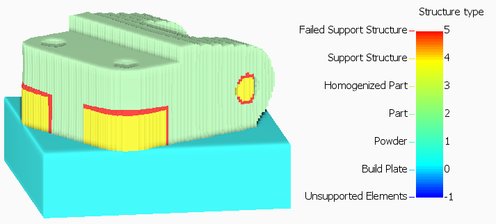

Mesh Preview results for powder bed fusion models include the Structure type, which can be used to check whether the proper settings and conditions have been selected.
