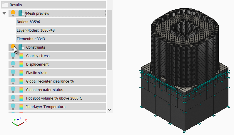

This Results option displays the mechanical constraints applied to the build plate.
Fixed bottom constraints on a powder bed fusion build plate

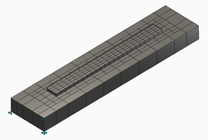

Cantilever constraints on a DED build plate
The number of constraint arrows shown varies, depending on which Plate fixture option is specified in the Build Plate settings.
