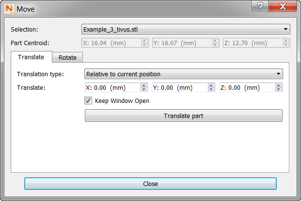

To translate a part relative to current position
  1. Select the Translate tab.
  2. Set Translation type to Relative to current position.
    Note that X, Y, and Z values are zeroed.
  3. Set X, Y, or Z distance values to specify how far to move the selected part.
    Positive values move the part away from the origin; negative values move it toward the origin.
  4. Click Translate part.
    The part moves the specified distance and direction.
To translate a part to an absolute position
  1. Set Translation type To absolute position.
    Note that X, Y, and Z values are set to the current location of the selected part.
  2. Change the X, Y, and Z values to the desired location of the part.
    Lower numeric values move the part toward the origin; higher values move it away from the origin.
  3. Click Translate part.
    The part moves to the new location.

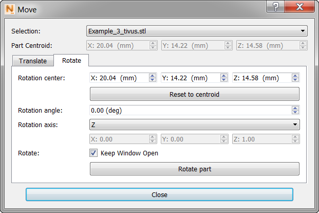

To rotate a part precisely on an axis
  1. Select the Rotate tab.
  2. Set the Rotation angle value in positive or negative degrees.
  3. Set the Rotation axis to X, Y, or Z, noting that the part will rotate around the selected axis.
  4. Click Rotate part.
    The part snaps to the rotated position.
