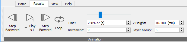

Click
Play
to see a looping animation of the simulation results, with color changes to indicate the extent of displacement or temperature change as the part is built. On a drop-down menu, you can select x2, x4 or x8 to increase the play speed by multiples. Click
Loop to repeat the animation over and over; click Play again at any time to stop the action.
On the time slider, you can click and drag the marker to review specific parts of the animation, or use the Step Forward and Step Backward arrows to move one increment at a time.
The Time entry shows the time associated with the current increment. The up and down arrows can be used to step through the time steps.
The Increment entry shows the current increment number. The up and down arrows can be used to step through the increments, or you can jump to a select increment by typing it into the Increment field and pressing Enter.
The Z Height and Layer Group controls work together, in that pressing the up or down arrow in either field steps you up or down the layer numbers, and displays the corresponding Z height of the build.
