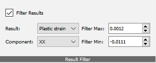

Control the component displayed for different result types, and the range of values displayed. The following result types cannot be filtered:
- Global Recoater Clearance
- Global Recoater Status
- Principal Stress Direction
- Interlayer Temperature
- Lack of Fusion Temperatures
- Hotspot Temperatures
Filters set for eligible results are persistent within the session, so you can review and compare filters for different result types.
