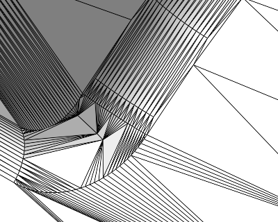

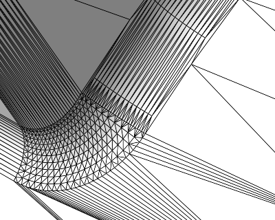

This parameter specifies the maximum allowable distance between generated mesh triangles and the model geometry. Tip: If you have two rounded bevel edges meet at a corner, setting this to a smaller value will ensure that the corner is properly rounded, too.
Millimeters | 0.05-20 mm |
This is the same location of several beveled edges meeting, one with 1 mm, the other with 0.05 mm maximum surface deviation. |

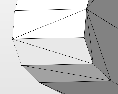

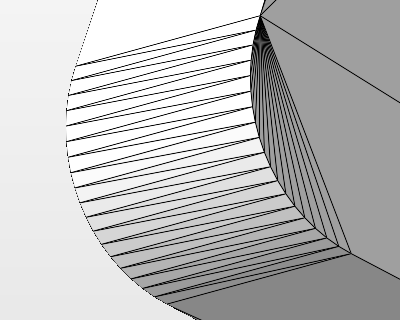

Degrees | 0.1-40° |
This is the same corner, one with 40 °, the other with 5 ° angle tolerance, imported with an otherwise rather high maximum surface deviation. |
