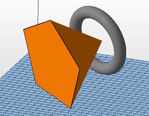

Example for two parts where neither can be removed along the z-axis without a collision
