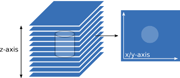

An important task of additive build processes is to slice 3D objects and optimize the data on each layer.
The thickness of each layer is a variable value, and theoretically it can have any value. The number of layers is the model’s height divided by the layer thickness. For example, layer number 5 would be the layer at position:
'Lowest z-position' + (5 * 'layer thickness')
