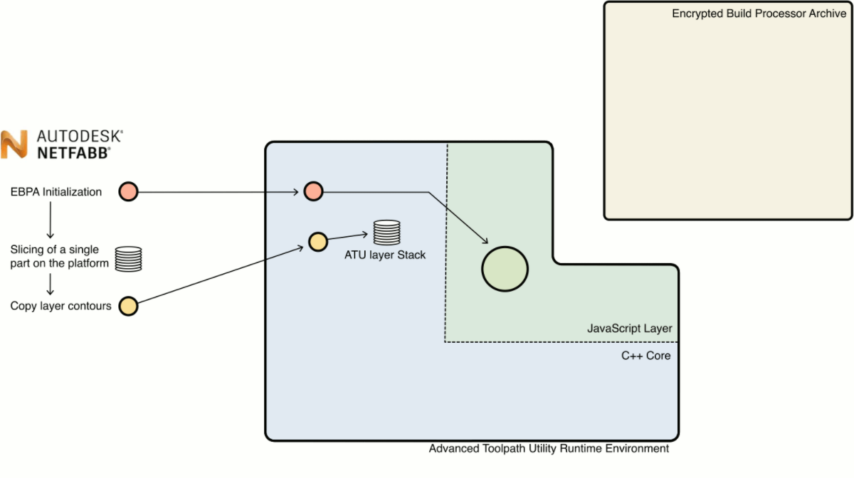

With the ability to change layer contour data and to create toolpaths and machine buildfiles, the ATU build processor can be used for various tasks. To ensure a consistent behavior across different host applications (eg. Autodesk® Netfabb®), a strict integration workflow for host applications was set up to guarantee identical processing results. It is important for every ATU developer to be aware of this workflow, because it influences operation order and data management of ATU JavaScript projects:
Host application workflow
| EBPA initialization |
The Netfabb integration is taken as an example:
ATU-side of this workflow

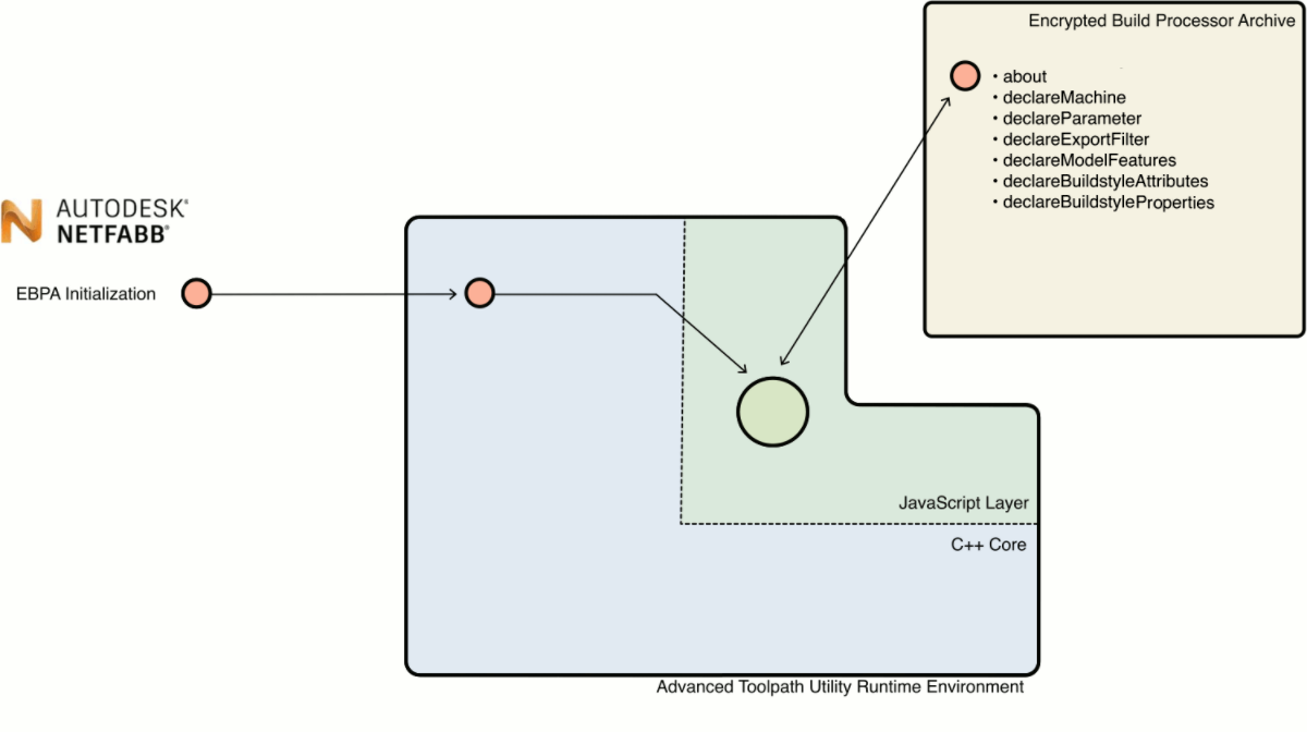

Initialization
The initialization makes all files of an EBPA archive available and calls the following Javascript functions:
| about | This function returns description and copyright information from used EBPA files. |
| declareBuildstyleAttributes | Buildstyle attributes are used to add parameters to the toolpath. They have to be declared at this function. |
| declareExportFilter | All available export formats are listed here so that the host application can choose from them. |
| declareMachine | The buildstyle sets up machine and materials for EBPA calculations. Since buildstyles can support more than one material, the host application queries a list of supported materials, which are specified here. |
| declareModelFeatures | Some special operations can be turned on or off here (Hull/Core generation, shadow polygon etc.) |
| declareParameters | Each buildstyle can have its own set of parameter groups and parameters. This function sets up available groups and parameters. |
| declareBuildstyleProperties | Define arbitrary additional properties. These properties can be read by the host program (e.g. ATU or Netfabb) directly. There are some predefined properties such as adsk_main.custom_thickness_allowed. |
Layer contour data
Any slicer can be used with the ATU runtime. In case of Netfabb, the Netfabb slicer module creates layer contour data from each part on the platform. These contours are transferred to the ATU runtime and they are saved to an ATU layer stack. This layer stack is the central database for all contours and toolpaths. All following operations query, add, modify or delete data on this central data storage.

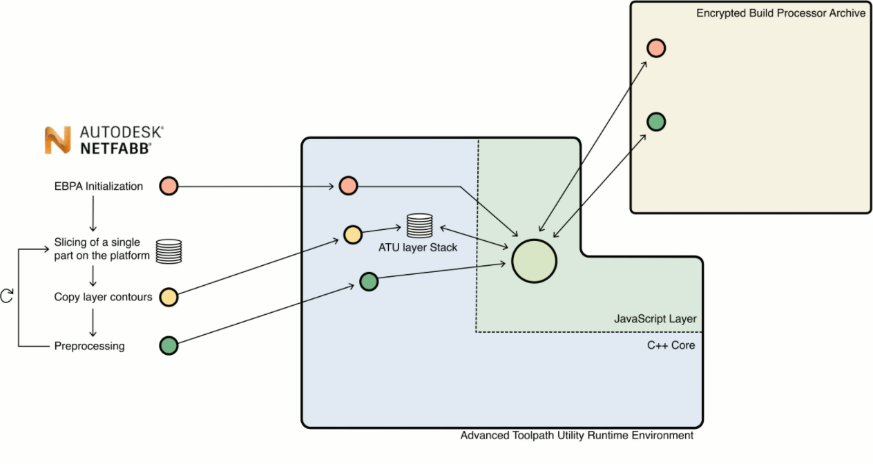

Preprocessing
At this stage, customized JavaScript code can be used to analyze, add, modify or delete layer contour data from a part and its supports.

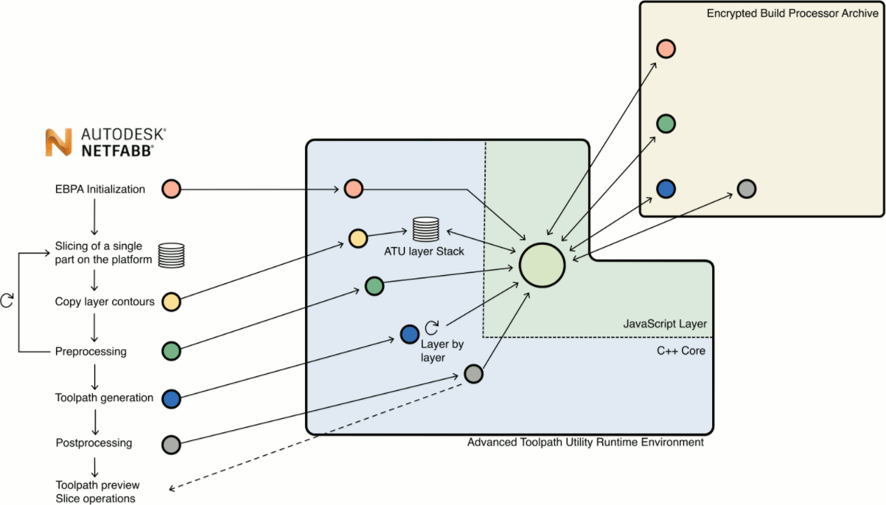

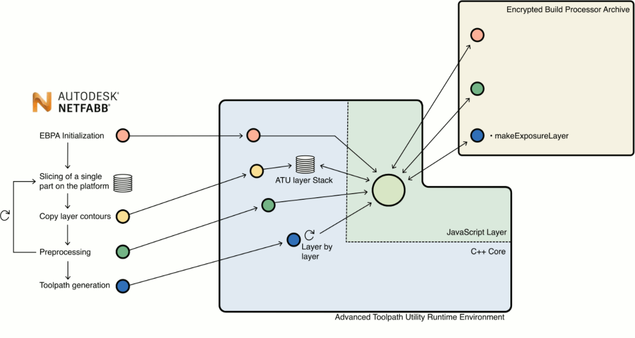

Toolpath generation
Toolpaths are generated by a thread at the ATU runtime environment. For every layer the makeExposureLayer javascript function is called to generate toolpaths for each layer.
Postprocessing

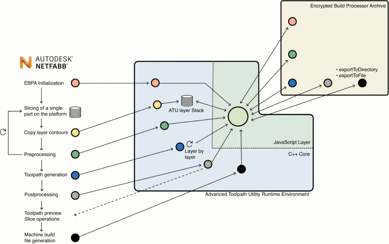

The postprocessing step is the first place, where contours and toolpaths of all parts and all layers are available. It is commonly used to create the overall processing order of all toolpath vectors. The postprocessed toolpath data can be used to create toolpath previews or it can be used for further processing at Netfabb slicing.
Machine buildfile creation
Similar to the postprocessing step, all toolpaths of all layers can be accessed here to generate machine/vendor-specific buildfiles.

- At the preprocessing phase, the ATU program has guaranteed access to contours of a single part only, because parts are added one after the other.
- Toolpath generation is done multithreaded and the Javascript implementation is called once for each layer. The processing order of layers is managed by a thread and it is not safe to access toolpath data from other layers (but it is safe to access contour data from other layers, as they are generated while layer contours are copied or at the preprocessing step)
- Toolpaths are generated for single parts. The makeExposureLayer function only has access to contours of this single part.
