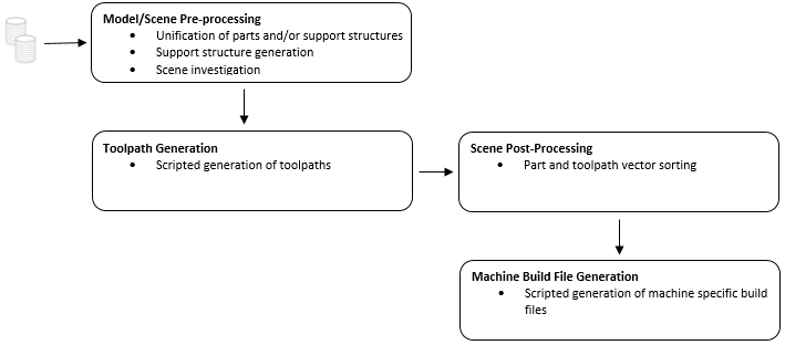

Planning the processing of toolpaths with Advanced Toolpath Utility
Planning the processing of toolpaths is complicated because both toolpath generation and post-processing have an impact.
Toolpath generation
At this point the part and support contours are being processed and the toolpath is generated. Toolpath optimization strategies can already be applied while toolpaths are being generated and the source of all toolpaths (the related model, islands, or polylines) are still available to help inform organizational decisions.
Since toolpath generation is model specific, we only have information about one (the current) model and not about the whole build platform. This is a good place to group toolpath geometry to "packages" (bsHatchBlocks within a bsHatch instance), which won't get split up any further later in the post-processing step, and to add special processing flags and parameters (i.e. toolpath source information, which won't be available any more in the post-processing step).
Post-processing
The post-processing step gives access to geometry elements of all platform layers (remember, the toolpath generation only had access to one model of the platform). At this phase, it is complicated to generate new toolpaths, so it is mostly used to rearrange the processing order of existing toolpath element groups. This is also the place to make decisions about the processing order of parts, because all toolpaths of all models are accessible.
