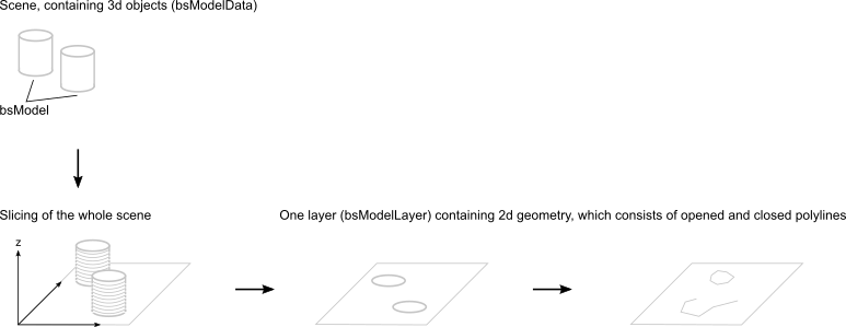

Creating toolpaths for additive manufacturing processes always involves working with geometry. With a few exceptions only 2D geometry comes into place, because toolpaths are generated for each layer of sliced 3D objects. The following picture demonstrates all buildstyle processing steps being done by the Advanced Toolpath Utility build processor, before any toolpath creation actions can be started with buildstyle projects:
It starts with a scene of 3D meshes from the parent application (i.e. Netfabb), which is passed to the Advanced Toolpath Utility build processor mesh by mesh. From within buildstyle projects the scene can be accessed using bsModelData objects. Each mesh (model) is stored at the bsModelData object as a bsModel object.
The Advanced Toolpath Utility buildstyle processor slices the whole scene and stores a bsModelLayer object for each slice (layer). Every layer contains 2D geometry data for all meshes, that intersected with that layer. These layers are filled with polylines (sets of connected points) and these polylines can either be closed (start and end point are connected) or opened (start and end points are not connected).
These polylines are the source for the toolpath creation process and they contain all information, which is needed to generate toolpaths. The Advanced Toolpath Utility build environment, however, offers two other types of geometric objects. These are bsPathSet and bsIsland. Both types are lists of polylines. Objects of type bsPath may contain several opened or closed polylines. Objects of type bsIsland may contain several closed polylines.
Polylines can only be accessed by bsModelLayer objects using a write protected bsPolylineIterator.

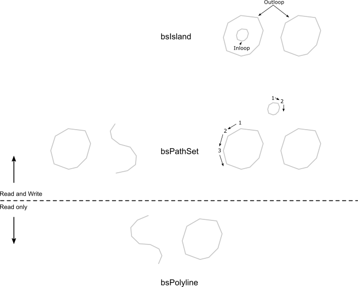

A bsPolylineIterator is used to get 2D geometry from a bsModelLayer. Either all 2D geometry or 2D geometry of the following types can be accessed with bsPolylineIterator instances:
  • Closed polylines (bsPolylineIterator.nIslandBorderPolygons) of part and support geometry.
  • Open polylines (bsPolylineIterator.nLayerOpenPolylines) of part and support geometry.
  • Toolpath polylines (bsPolylineIterator.nLayerExposure). This type of polylines is discussed in the toolpath creation chapter.

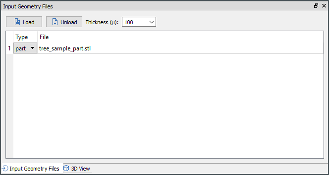

The example buildstyles don't use any meshes from the input geometry at all. The preprocessLayerStack function is used to construct geometry exclusively within the buildstyle. Of course, this isn't a real world example, but it is a good start to get familiar with Advanced Toolpath Utility's geometry concept.
All buildstyles will refuse to work, without having any input geometry, so it is necessary to load a geometry file even if it isn't used later on.

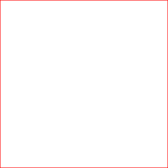

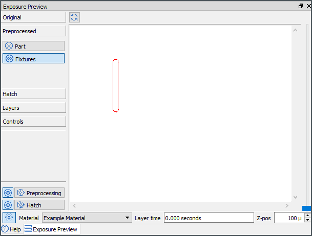

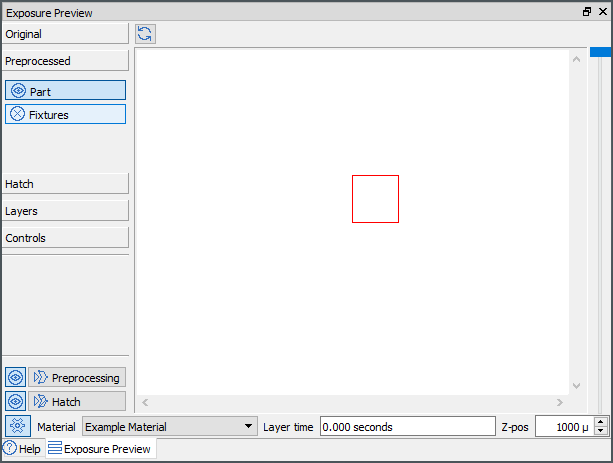

For a start, use the Advanced Toolpath Utility to open the first geometry example buildstyle at C:\ProgramData\Autodesk\ATU\ATU-Examples\tutorial-projects\geometry\01_2d-Geometry\. Now, open the Input Geometry Files widget and add the tree_sample_part.stl file as a part to the project. The layer thickness should be 100 micro meters. It can be found ZIP-compressed at C:\ProgramData\Autodesk\ATU\ATU-Examples\Geometry files\.
Hit Compile and check, if you can see a red rectangle at the exposure preview widget.

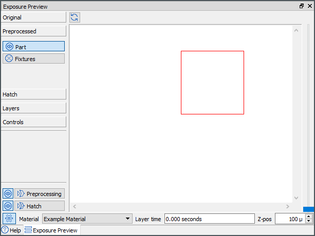

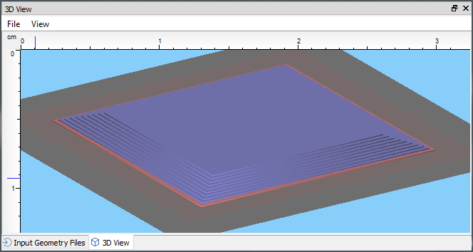

Examine Buildstyle Calculation Results

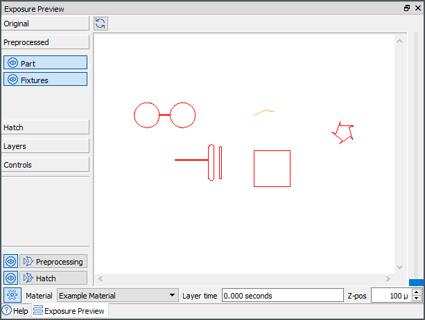

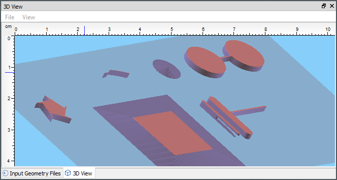

The exposure preview and the 3D view panel can be used to examine the calculation results. The exposure preview panel shows ten layers and their positions (preprocessed geometry has to be visible. Check the exposure preview's visibility options):
Cycling through the layers resizes the rectangle on the screen. The rectangle always gets a bit smaller on higher layers. The 3D view demonstrates this by showing a pyramid:

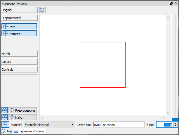

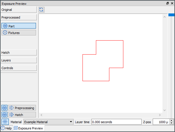

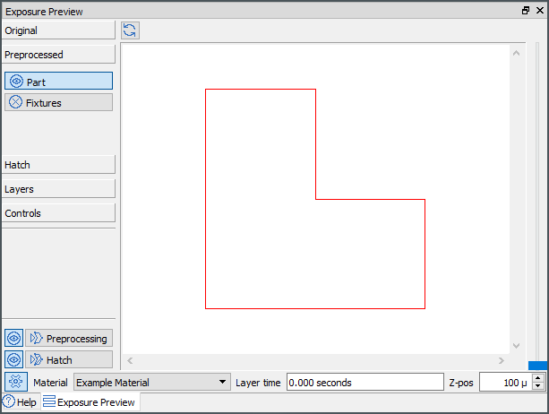

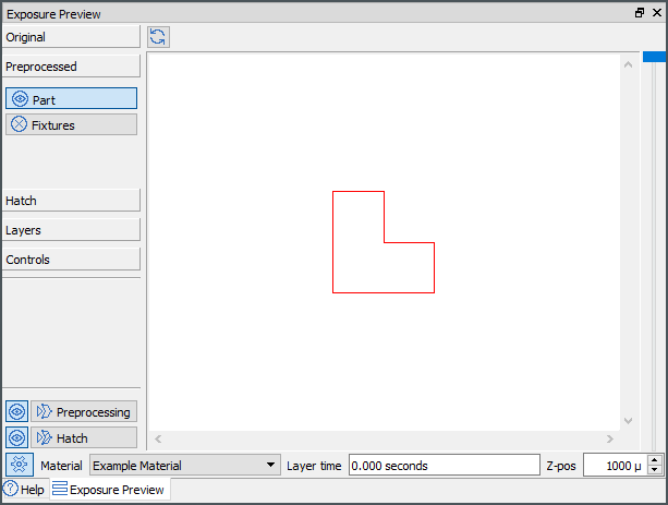

The exposure preview panel allows to show or hide part and support geometry. The Preprocessed section of the tab control on the left side can be used for this. Hiding the support structures (Fixtures) shows the clipped rectangle only:
Keeping intersected area Keeping non-intersected area

  var cPoint3 = new VEC2.Vec2(15.0,0.0);
  var cPoint4 = new VEC2.Vec2(15.0,15.0);
  secondRectangle.addNewPath(cPoint1,cPoint2,cPoint3,cPoint4);
  secondRectangle.setClosed(true);
  rectangle.booleanOpUnify(secondRectangle);
  //rectangle.booleanOpSubtract(secondRectangle);
  //rectangle.booleanOpIntersect(secondRectangle);
  layer.addPathSet(rectangle, MODEL.nSubtypePart);

The previously constructed rectangle is added to the layer as a support structure.
layer.addPathSet(rectangle, MODEL.nSubtypeSupport);
A new, intersecting rectangle is constructed:
var clippingRectangle = new PATH_SET.bsPathSet();
var cPoint1 = new VEC2.Vec2(0.0, 15.0);
var cPoint2 = new VEC2.Vec2(0.0,0.0);
clippingRectangle.addNewPath(cPoint1,cPoint2,cPoint3,cPoint4);
clippingRectangle.setClosed(true);
One of three different boolean operations is used:
The processed rectangle is added to the layer as a part:
Top
The exposure preview panel allows to show or hide part and support geometry. The Preprocessed section of the tab control on the left side can be used for this. Hiding the support structures (Fixtures) shows the processed rectangle only:
Unify Subtract Intersect
Top
Intersection Detection, Point Reduction, and Path Offsets
The buildstyle can be found at C:\ProgramData\Autodesk\ATU\ATU-Examples\tutorial-projects\geometry\04_Extra\.
For the most part, this buildstyle is identical to the one above 01_2d-Geometry. It creates a model with ten layers and each layer contains a rectangle.
The new code is added as a new JavaScript file, called demonstration.js. For each layer the demonstration function is called after creating the rectangle. The constructed rectangle and the layer object are passed to the new function.
exports.demonstration = function(layer, rectangle)

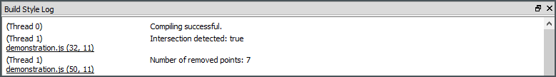

  var result = rectangle.detectIntersection(clippingRectangle);
  process.print('Intersection detected: ' + result);

  var removed_points = path.reducePointsInTolerance(0.5, 0.5);
  process.print('Number of removed points: ' + removed_points);

The last operation creates an offset around the open path and adds the offseted path as a support structure to the layer.
path.createOffset(0.5);
layer.addPathSet(path, MODEL.nSubtypeSupport);
Top
The result of the intersection detection and the number of removed points are outputted to the buildstyle log:
The offset path is displayed at the exposure preview widget:

Test Geometry Buildstyle
The buildstyle can be found at C:\ProgramData\Autodesk\ATU\ATU-Examples\tutorial-projects\geometry\05_Hatch-Geometry\.
For the most part, this buildstyle is identical to the one above (01_2d-Geometry). It creates a model with ten layers and each layer contains a rectangle.
The new code is added as a new JavaScript file, called geometry.js. For each layer, the demonstration function is called. The layer object and the layer index are passed to the new function.
exports.createLayerGeometry = function(layer, layerIdx)
  createAMSensitiveStructure1(layer, layerIdx);
  createAMSensitiveStructure2(layer, layerIdx);
  createAMSensitiveStructure3(layer, layerIdx);
  createOpenPath(layer, layerIdx);
  createOffsetedPath(layer, layerIdx);
  createUFO(layer, layerIdx);
  createPyramid(layer, layerIdx);
Top
Functional Description
This buildstyle does not use any new operations. It creates test geometry as a preparation for the following tutorial projects.
Top
Exposure Preview 3D view
