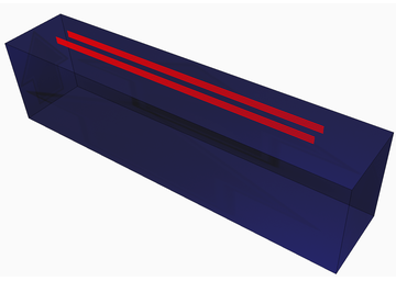

# power, laser vector x, y, z, normalization optional, start point x, y, z, end point x, y, z, radius, velocity, start time # separated by single spaces or commas 450 0 0 -1 19.05 11.7 0.2 57.15 11.7 0.2 1 10 0 450 0 0 -1 57.15 13.7 0.2 19.05 13.7 0.2 1 10 3.9 450 0 0 -1 19.05 11.7 0.4 57.15 11.7 0.4 1 10 7.8 450 0 0 -1 57.15 13.7 0.4 19.05 13.7 0.4 1 10 11.7 450 0 0 -1 19.05 11.7 0.6 57.15 11.7 0.6 1 10 15.6 450 0 0 -1 57.15 13.7 0.6 19.05 13.7 0.6 1 10 19.5 450 0 0 -1 19.05 11.7 0.8 57.15 11.7 0.8 1 10 23.4 450 0 0 -1 57.15 13.7 0.8 19.05 13.7 0.8 1 10 27.3 450 0 0 -1 19.05 11.7 1 57.15 11.7 1 1 10 31.2 450 0 0 -1 57.15 13.7 1 19.05 13.7 1 1 10 35.1
Deposition paths from the file example above, visualized on a custom substrate specified by resizing the buildplate
