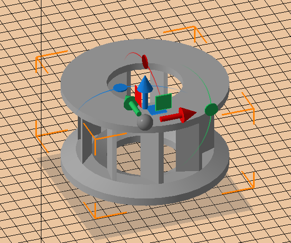

- Load the demonstration part stator v1.step.
- Orient its circular faces parallel with the build platform and arrange it well away from the platform borders to give the supports you are about to generate some room.
The stator demo part in the buildroom, with some leeway around and below it

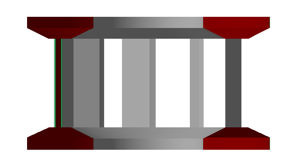

Using clip planes
- With the part oriented and arranged on the platform, move the Y slider in the Clip planes view until the line representing the plane crosses the part about half-way.
- Click the left part of the
visibility icon to toggle the negative-Y-facing section.
- Click the FRONT face of the viewcube to switch to the perspective looking directly in positive Y direction.
A look directly at the cross section of the part reveals angled inner and outer flanges and a level center track holding the vanes.

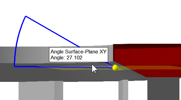

- In the 3D view, move the mouse pointer over the angled surface of the outer flange of the upper ring. This already highlights the respective triangle, plane reference, angle measurement, and numerical readout.
Note: Even though the part is still in CAD format, Netfabb triangulates its surface for its functions. As such, select a representative triangle for the measurement as there is no way to average a surface measurement across multiple triangles available.Tip: Hold the right mouse button and drag the mouse to vary the view before deciding which triangle to measure against.
- Click once to select the triangle.

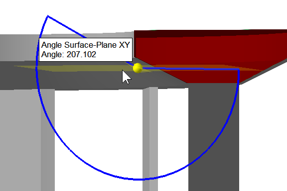

- At this point, Netfabb may not have given you the best arc for your measurement of the downskin angle. Choose a suitable arc by moving the mouse pointer around the angle's apex, marked by the yellow bubble. Once you have found the desired arc, click once more to select it and finalize this angle measurement.
Move the mouse around the angle apex to select the desired arc.
Now the downskin angle can be read off directly. Click to finalize the angle measurement.
Repeating the same angle measurement steps for the outer flange reveals that they are effectively equal. This means that the value of the angle alone cannot be used to distinguish between the inner and outer flange, only between flanges and the flat portion of the downskin. As such, another property is required, and for this we use the surface area.

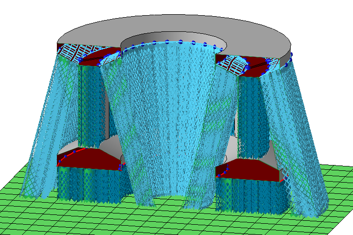

- From the actions dropdown, select Area with volume support and click Add.
- Click Save, then Execute.

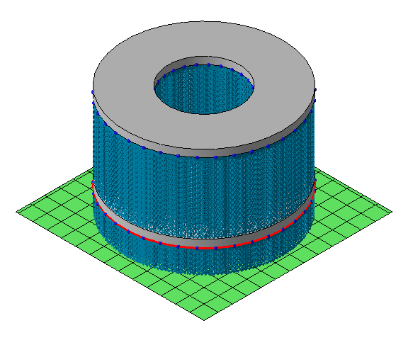

First-pass volume supports on the stator part
Identifying clusters, part 1

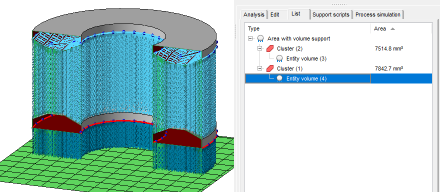

- With the first-pass volume supports generated, switch to the List tab in the context view.
- Expand the nodes of the tree view to see which clusters were generated and which support entities belong to them.
Selecting entries in this tree view highlights the respective clusters and entities in the 3D view. (The bracketed numbers are the respective element's identifier.)
In this first pass, the entire downskin is supported as a singular cluster. To differentiate between the sections and to force support generation into detecting them as separate clusters, the support script needs a more granular strategy.
