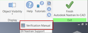

If the Autodesk Inventor Nastran ribbon is not visible, go to the Environments tab and, in the Begin panel, click Autodesk Inventor Nastran (). The Autodesk Inventor Nastran ribbon tab is displayed.
Expand the Nastran Support panel and click Verification Manual to open this document, which is a PDF file.
