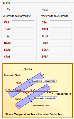

Nitinol material is used only in Nonlinear analysis. After selecting Nitinol from the Type drop-down, the following material sections will become available: General, Structural and Nitinol.
  • General and Structural
    • You can input Young’s modulus, shear modulus, Poisson’s ratio, thermal expansion coefficient, mass density under the General and Structural section.
  • Nitinol
    • This material property is used for shape memory alloys.
    • It needs pressure coefficient and maximum residual strain .
    • The transformation stresses and temperature can be combined such that the transformation stress can be calculated by using the data specified for autensite to martensite and vice versa.
    • Starting stress for transformation from austensite to martensite is SSAS -CAS*TSAS.
    • Ending stress for transformation from austensite to martensite is SFAS -CAS*TFAS.
    • Starting stress for transformation from martensite to austensite is SSSA -CSA*TSSA.
    • Ending stress for transformation from martensite to austensite is SFSA -CSA*TFSA.
    • Temperatures should satisfied relation:
      TFAS<TSAS<TSSA<TFSA
    • When BTAS and BTSA are zero, the material model is linear. When BTAS and BTSA are non-zero, the material model is exponential with BTAS and BTSA as coefficients.
