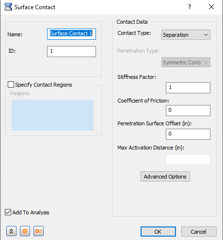

This option allows you to define Automatic Surface Contact Generation (ASCG) for the model (globally) or for specified contact regions. It allows you to override the default contact settings defined within the Analysis dialog (unlike the fully Automatic contact generation command ofInventor Nastran).
When selecting the Solver option, the following sections are available:
- Specify Contact Regions: It allows you to limit contact generation to user-specified regions of the model. Select the entities you want to consider for contact generation. The selection must include both entities (Primary/Secondary) in the contact regions. It is not sufficient for you to select a single entity in a contact region.

- Add To Analysis: Surface contacts generated this way can be applied to an analysis by clicking the
Add to Analysis checkbox. You can also drag and drop, or copy and paste, contact pairs from the

Contact Data:
- Contact Type: In this section, different types of contact can be generated and disabled. Note that the Contact Type terminology now matches Inventor Stress Simulation terminology. Moreover, when you hover over the Contact Type drop-down menu, tool tips are available to show the Nastran terminology, as you can see in the image below:

- Stiffness Factor: This value controls the stiffness scaling of the contact. The stiffness is automatically determined based on the adjacent stiffness.
- The higher this value, the stiffer the contact and the less the penetration, but too high a value may cause convergence issues and chatter.
- Sometimes setting this to a lower value may help convergence, but usually the default (1.0) works well for Autodesk Nastran analysis.
- Coefficient of Friction: Specify a coefficient of static friction.
- Penetration Surface Offset: Specify a penetration surface offset. This defines a numerical offset value for instances such as plate to plate or solid to plate contact.
- Max Activation Distance: This is a tolerance value that specifies the distance that contact elements should be activated. This helps limit the number of contact elements and therefore decreases solution time prevents unnecessary, and possibly conflicting, contact elements. When the box is checked and no value is specified, the default solver distance will be used. This is a large distance based upon the model size. When a value is input, the solver will use that value. When the box is unchecked the auto function will be used. Using the auto setting, the solver determines the activation distance. This is different from when the box is left blank and the default solver value is used.
