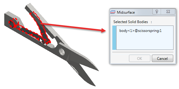

  1. Click Autodesk Inventor Nastran ribbon Prepare Midsurfaces. The Midsurface dialog appears:
  2. Click one or more bodies to select them for conversion to midsurfaces. Each one you click is listed in the Selected Solid Bodies box.

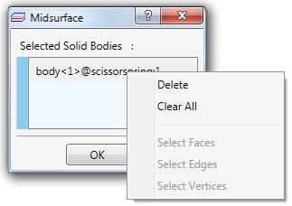

  3. You can right-click items to Delete them from the list, preventing their conversion to midsurfaces. Use the Clear All command to remove all solid bodies from the list. You can also graphically select bodies to convert to midsurfaces, adding them to the list.

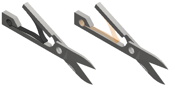

  4. Click OK to continue or Cancel to abort the operation. The selected solid bodies are suppressed and replaced by midplane surface representations (midsurfaces). New midsurfaces are listed in the Idealizations\Shells branch of the model tree.

The following images compare a CAD model before and after using the Find Thin Bodies command. The solid spring on the left is replaced by the midsurface spring on the right:
