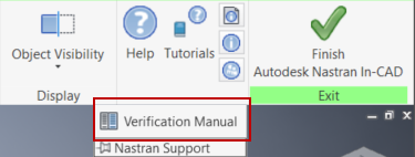

If the
Autodesk Inventor Nastran ribbon is not visible, go to the
Environments tab and, in the
Begin panel, click
Autodesk Inventor Nastran (
). The
Autodesk Inventor Nastran ribbon tab is displayed.
Expand the Nastran Support panel and click Verification Manual to open this document, which is a PDF file.
