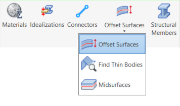

Prepare |
New Material New Idealization New Connectors Create Offset Surfaces Create Midsurfaces Choose Representation of Structural Members |

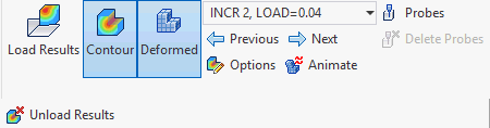

Solve |
Display Contour Plot Display Deformed Plot Edit Plot Combo Box (Select Subcases / Increments / Modes / Time Steps / Frequencies) Previous Step Next Step Options - Edit Results (see Plot Templates section) Probe - Query Results Delete Probes (removes probes you have anchored to the model) Unload Results (Click Expand arrow to access) |
