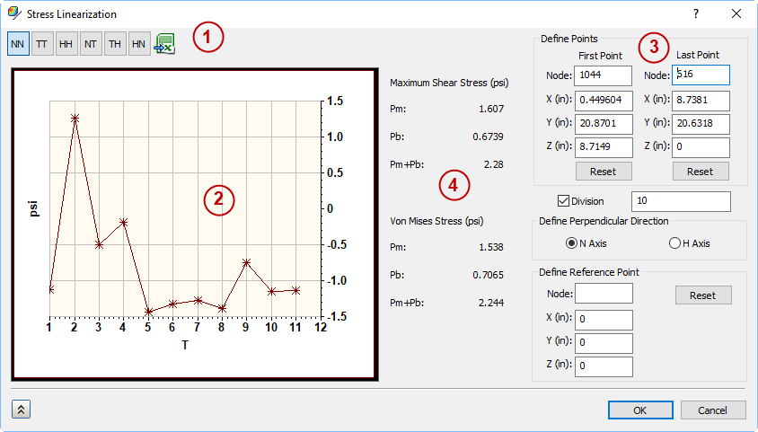

The Stress Linearization utility dialog includes the following controls, as numbered in the figure above:
- Local Stress Tensors: These selections allow you to choose which result to plot in the graph. The green button
is used to save the numeric results in a .CSV file
- Stress Linearization Graph: The graph displays the local stress tensor results along the currently defined Stress Classification Line (SCL).
- Linearization Controls: The linearization controls allow you to specify the first and last point to define the SCL. You can also define the orientation of the local stress tensor graph.
- Stress Linearization Results: Results are displayed for both the Maximum Shear Stress and the Von Mises Stress:
- Pm: The general primary membrane stress intensity for the current SCL.
- Pb: The primary bending stress intensity for the current SCL.
- Pm + Pb: The total primary stress for the current SCL (sum of the primary bending and primary membrane stresses).
