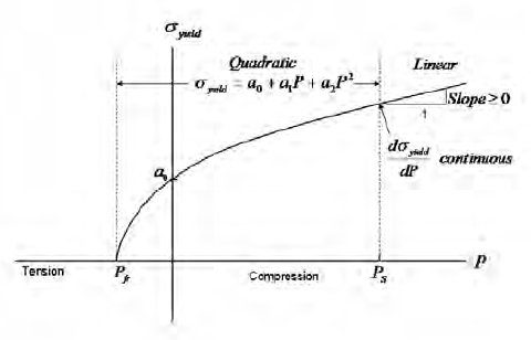

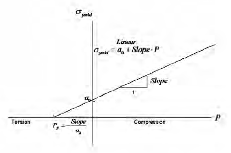

- The deviatoric yield stress is pressure dependent and the dependency can be either linear or quadratic. For the linear case (MODEL=1), shown in Figure 1, the user specifies the yield at zero pressure, A0, and a constant slope for the yield stress as a function of pressure, SLOPE. This defines a conical shape of the yield stress versus pressure surface as shown in Figure1. For the quadratic case (MODEL=2), shown in Figure 2, the user specifies A0, SLOPE, the pressure as the specified slope, PS, and the yield at the specified slope, YS. The coefficients A1 and A2 of the quadratic dependency are automatically determined from the user supplied parameters. The value of the tensile volumetric fracture pressure is determined such that the quadratic curve passes through the user supplied value of A0 and matches the SLOPE provided at the pressure (PS,YS).
Figure 1: Linear Dependence of Yield Stress on Pressure (MODEL=1)
Figure 2: Quadratic Dependence of Yield Stress on Pressure (MODEL=2)

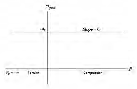

- A value of zero is allowable for the SLOPE for the linear case (CMODEL=1). This specifies a constant yield stress, independent of pressure as shown in Figure 3. In this case, the tensile volumetric fracture pressure is assumed to be infinite (i.e. no tensile failure occurs).
Figure 3: No Pressure Dependence of Yield Stress (MODEL = 1)

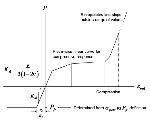

- The EVn, Pn points define the piecewise linear behavior of the pressure versus volumetric strain in compression as shown in Figure 5. At least 2 points must be provided, in which case a linear response in compression is defined. The first point (EV0, PV0) must be defined at zero strain and pressure. The tensile volumetric response is purely elastic up to the point of tensile volumetric fracture defined by
Pfr, which is determined from the deviatoric coefficients as described in Remark 1.
Figure 5: Pressure vs. Volumetric Response Curve
