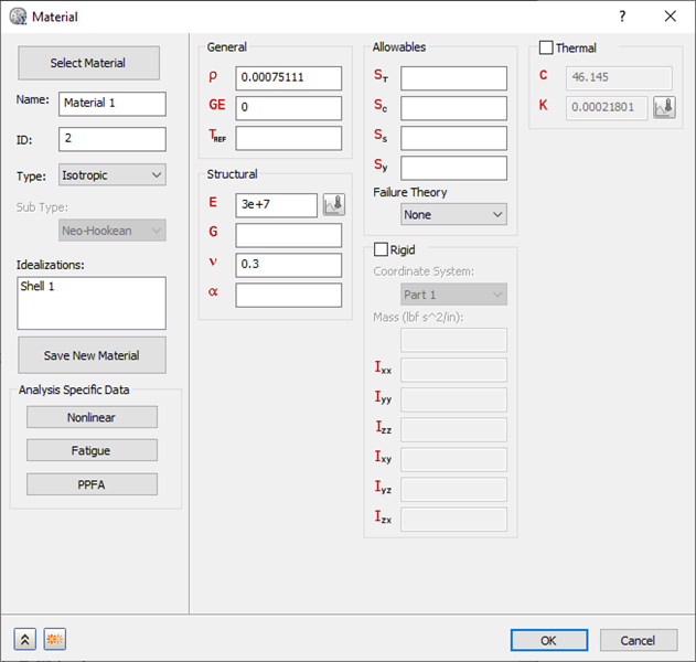

- In the Model tree, right-click on Materials and select New.
- Change the Name to Steel.
- In the
Structural group, enter
30E6 in the
E input box and
0.3 in the
ν (nu) input box.
- Click
OK.

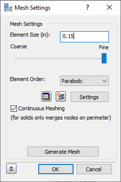

- Right-click on Mesh Model and select Edit.
- Change the
Element Size to
0.15.
- Click
Generate Mesh and then click

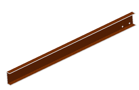

OK. The model should look as shown below.

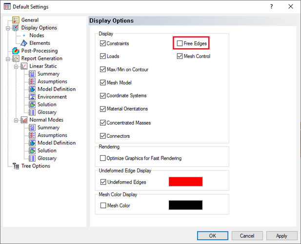

To remove white color edges, go to Default Settings
, then Display Options, and uncheck Free Edges.
