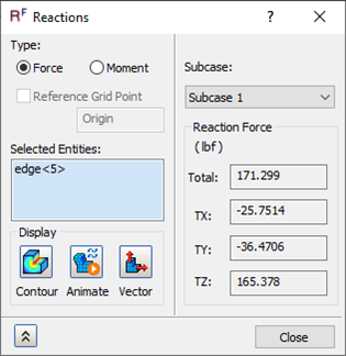

  1. Right-click on Subcase 1 (or Subcase 2) and select SPC Summation.

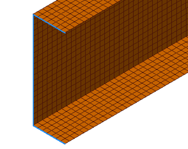

  2. Click the three edges where the enforced displacement loads were applied. Loads are hidden for display clarity.
    The TOTAL is the resultant force of TX, TY, and TZ. And TX, TY, and TZ are in the global coordinate system.

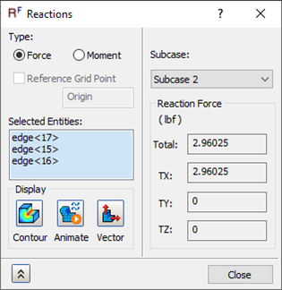

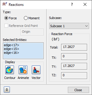

  3. Change the Subcase drop-down to Subcase 2 to see the load forces required to deflect the beam 0.025 inches in the x-direction. When finished, Close the dialog box.
    For easy access of SPC Summation for the constraint ends, right-click on Constraints and select SPC Summation with the selection of constrained entities.

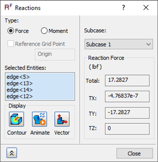

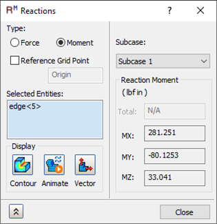

  4. Right-click Fixed Holes constraint and select SPC Summation. Make sure the Force radio button is selected to see the SPC Force Summation. Then select all the constrained edges listed in the Selected Entities list.

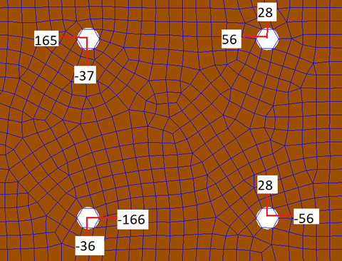

  5. Right-click in the Selected Entities box and select Clear All. Select the 1st hole in the channel as shown in the image below.
  6. Select Moment radio button for SPC Moment Summation.
  7. Looking at the individual reaction forces of each hole for Subcase 1 (using the methods described above), the results should be similar to what is shown below for the SPC Force Summation.
