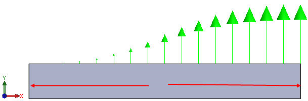

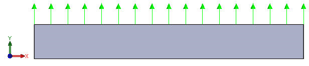

Define a unit load along the edge.

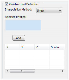

Check the Variable Load Definition box. Points and vertices may be used as Selected Entities, so it may be beneficial to create reference geometry when creating a variable load distribution for future models.

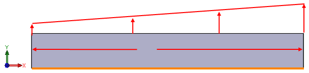

- Set the interpolation method as Linear. Select the two end points of the geometry using the Selected Entities selection box. It may be activated by clicking on it first.

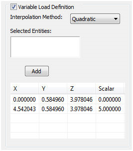

Click the Add button to add the three dimensional locations to the table.
The first point has a scalar value of 0.0 and the second point has a scalar value of 5.0. Double-click in the Scalar boxes to enter a value.
Notice that the curve is not a perfect linear curve, but parabolic. Based upon the dimensions above, it can be verified that the total load is 2.5.

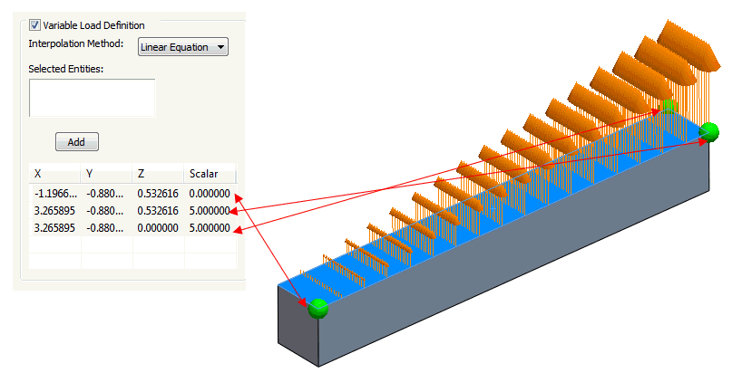

- Now change the interpolation method to Linear (Equation Based).
Notice that you will not be able to see the load arrows as the third point is missing for the surface. Select the third point and add it to the list and enter the same value of 5.0 as shown in the image below.

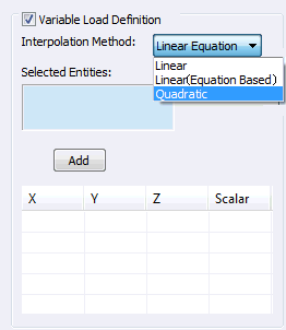

- Now change the interpolation method to Quadratic.

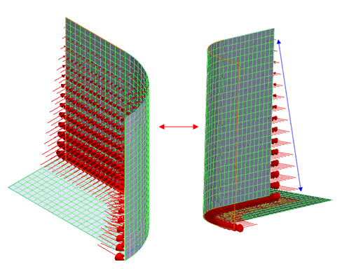

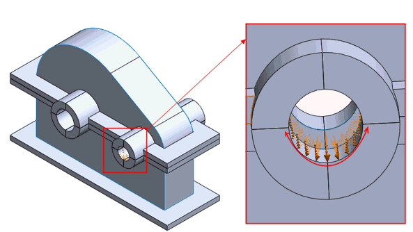

Example 2: Simple 2D Variation on Cylindrical Surfaces
To define a variable load on cylindrical surfaces (ex: bearing load), it is recommended to use the Linear option rather than Linear (Equation Based), as shown in the image below.
Example 3: Simple 2D Variation of Hydrostatic Load
To define a hydrostatic variable load, it is recommended to use the Linear (Equation Based) option rather than Linear, as shown in the image below

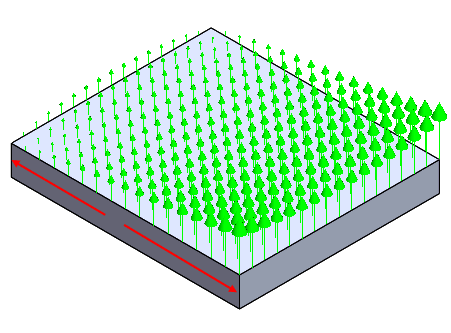

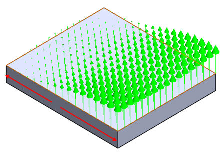

Example 4: Simple 3D Variation on Flat Surfaces
Using the same scalar surface points on a surface creates the following load distribution. The load distribution levels off to 1.0 (the unit value) the further the location from the data points.
Linear
Quadratic
