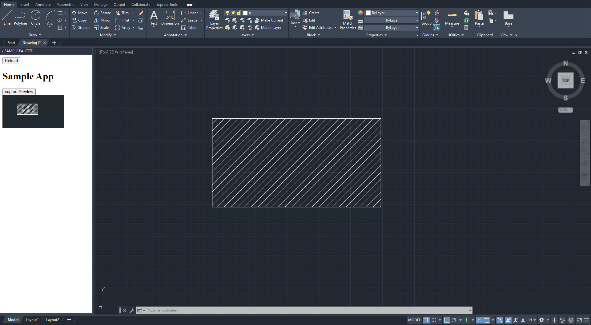

This AutoCAD JavaScript tutorial demonstrates how to implement a simple palette in AutoCAD and capture a preview image of the editor window.
In this tutorial you will,
- Create an HTML file that defines the appearance of the palette and a button to execute a JavaScript function
- Capture and display a preview of the drawing editor window in an IMG HTML element
- Use the
Acad.Application.activedocument.addPalette()
function to add a palette

At the AutoCAD Command prompt, enter webload and then press enter again to use the Load option.
At the
Enter javascript URL to load:
prompt, enter c:/AutoCAD/capture.js.Note: Replace "c:/AutoCAD/" with the location of your capture.js file.The "Sample Palette" should now be displayed in AutoCAD with a preview image of the geometry in the current editor window.
