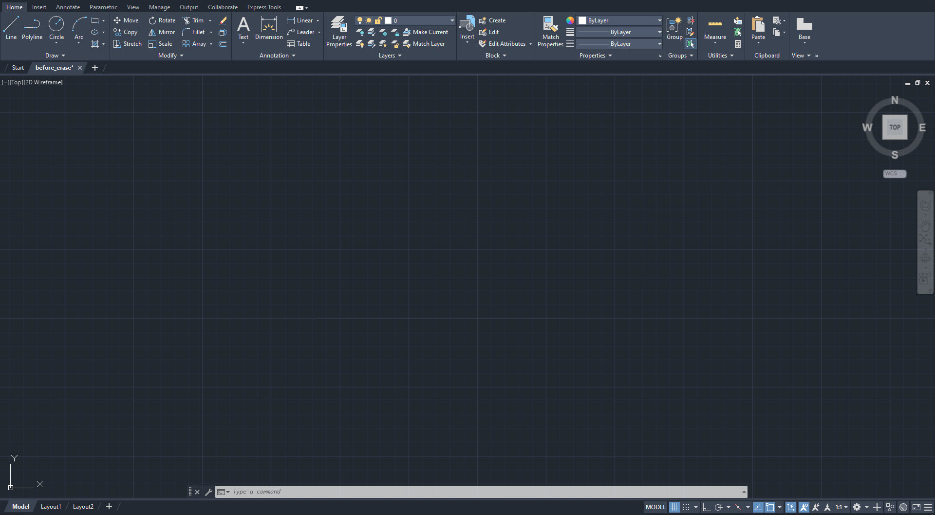

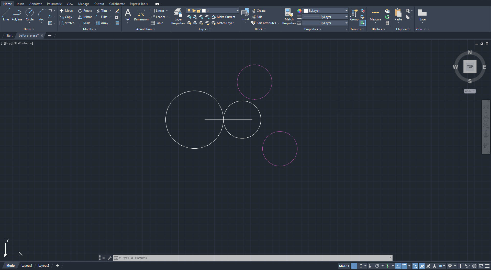

At the AutoCAD Command prompt, enter myerase.
All of the objects in the current drawing should now be erased.
