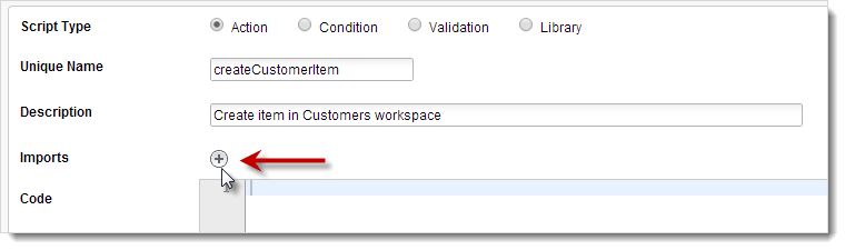

    Import library start
  3. In the Script Editor, click the Add Script button next to Imports.

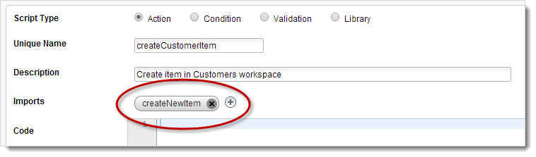

    A button for the selected script appears next to Imports.
    import library
    Tip:
    To remove a selected script from Imports, click the Delete icon on the script button. You can import more than one Library script into a target script. To import more scripts, repeat steps 3 and 4 until all the scripts are imported.

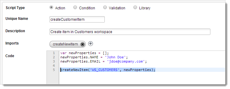

  5. In the Code text box, write the target script, calling the function in the Library script as needed.
    Best PracticeCall createNewItem (see step 4) to create a new item in a Customers workspace (WS_CUSTOMERS) and set values for NAME and EMAIL fields. import library code
