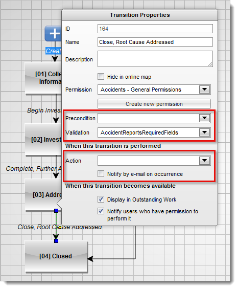

To connect the script to the transition
On the Administration menu, click Workspace Manager.
In the Workspace Manager, expand the workspace's panel and click Workflow Editor.
On the workflow mapping grid, double-click the transition's connector.
In the Transition Properties flyout, select the script name in the drop-down list for the type of script you are connecting to the transition.
For example, to connect an Action script, select the script name in the Action drop-down list.
On the tool bar, click Save, and then close the editor.
