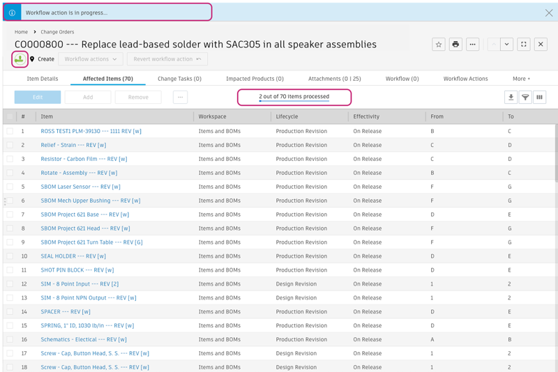

Asynchronous item release
By default, all linked or affected items release at the same time when the revisioning item reaches the Managed State. Administrators can change this behavior in General Settings by enabling Asynchronous item release, which releases items one by one in the background for faster, smoother processing.
When enabled, you can track progress in real time, and the workflow action completes automatically once all items are successfully released. If any affected items fail to release, you can retry the workflow action to complete the process.
Note: Asynchronous item release is not supported when a script triggers a workflow action that moves Change Orders to a Managed State. In this case, the items are released synchronously.
