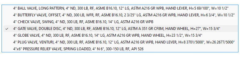

Substitute Parts
You can use the Substitution grip to replace compatible parts.
A compatible part has the same size and type (for example: you can substitute a gate valve with a ball valve).
