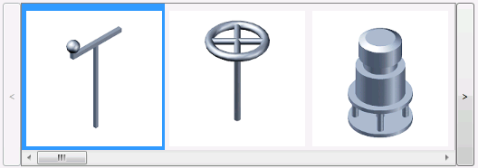

Valve Operators
Valves that support multiple operators are placed with a default operator such as a hand wheel or hand lever.
You can replace the default operator with a cone, a cylinder, or remove the operator (none).
You can also override the operator to specify a parametric shape or an AutoCAD block.
