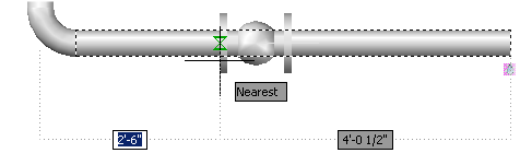

Piping components can be placed while routing. Components can be placed at midpoints and port locations.
Dynamic Input is supported when placing components from the spec viewer, tool palette, or when using the component move grip. The component move grip also supports moving to another pipe and changing the base point.
