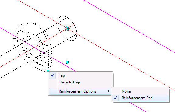

Welds and reinforcement pads are subobjects of a connector. You can press Ctrl when selecting welds to display properties and grips.
When you create a branch connection, you can specify a stub-in. After the stub-in is created you can add a reinforcement pad.
