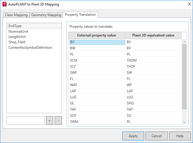

Property Translation (AutoPLANT to Plant 3D Mapping Dialog Box)
Translates AutoPLANT property values into Plant 3D equivalents.
The translations affect all classes in a project.
List of Options
Properties List
Lists added Plant 3D properties that receive values from the AutoPLANT spec and require translation.
Plus (+) Button
Adds a new Plant 3D property. Enter text into the box and click the + button to add a property.
Note: To reuse an existing script, right-click an existing property to copy the mapping information, then right-click the new property to paste the information. This action affects only this tab.
Minus (-) Button
Deletes the selected 3D property from the list.
Property Values to Translate
Displays a two-column table with AutoPLANT properties on the left and Plant 3D equivalents on the right.
  • External Property Value. Displays the AutoPLANT value for the property selected from the list on the left pane.
  • Plant 3D Equivalent Value. Specifies the Plant 3D equivalent value for the property selected from the list on the left pane. For example, the AutoPLANT endtype property value BW maps to BV in the language of Plant 3D.
