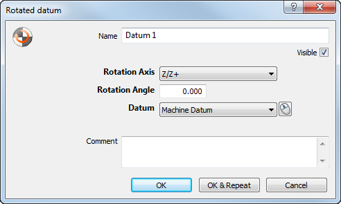

Use the Rotated Datum item to create a datum by rotating an existing datum around one of its axes by a specified angle.
To create a rotated datum:
  1. Click Alignments & Datums tab > Datums panel > Rotated.
  2. Enter a Name for the item. The name is used in the inspection sequence, in the Report and Info tabs, and when referencing the item in other items.
  3. To display the datum in the CAD view, select the Visible check box.
  4. Select the Rotation Axis for the datum.
  5. Enter the Rotation Angle for the datum.
  6. In the Datum list, select the datum you want to rotate.
    Click to select an item from the CAD view using the mouse.
  7. Enter any extra information about the item in the Comment box.
  8. Click OK to add the item to the inspection sequence.
