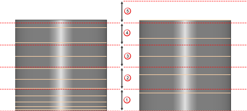

Layer-bands are used to create a common layering index for multiple features. This enables you to group together the toolpath passes of different features, which deposit material in various thickness ranges above the base surface.

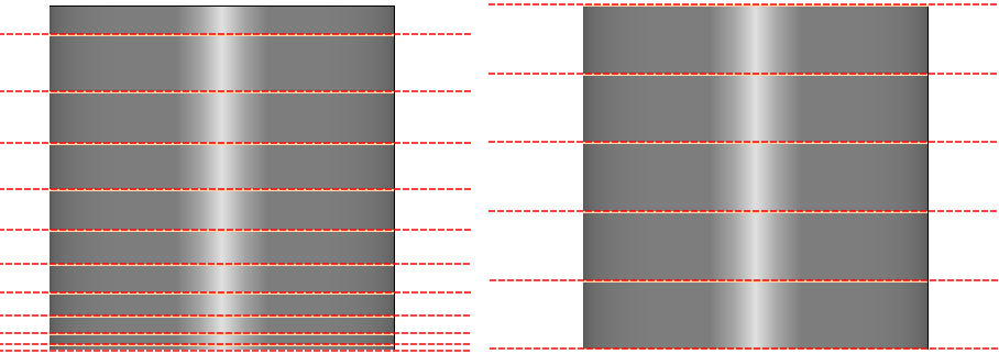

When a toolpath is initially calculated each layer is indexed, according to the consecutive passes above the base surface, into layer-bands. In this state the thicknesses and indices of each layer-band correspond to those of the physical layers.
After a toolpath has been calculated you can modify the thicknesses of the layer-bands and re-index them with respect to a common base surface. This results in each layer-band containing various amounts of physical layers.
When you have grouped your toolpath passes into layer-bands, you can split the original toolpaths by layer-band, into new toolpaths. This enables you to arrange the toolpaths so that material is deposited from the passes in each layer-band (for all features), before continuing onto the next layer-band.
