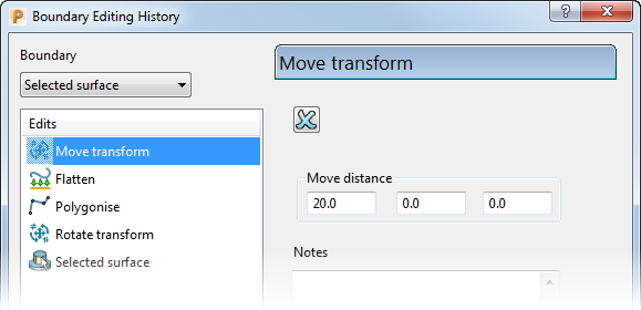

Edits — This pane displays a list of all the edits performed on the boundary. The most recent edit is at the top of the list and the original boundary is at the bottom of the list. The right side of the dialog displays information on the selected edit.
In this case, the edit moved the boundary by 20 mm in X and you can edit these values.

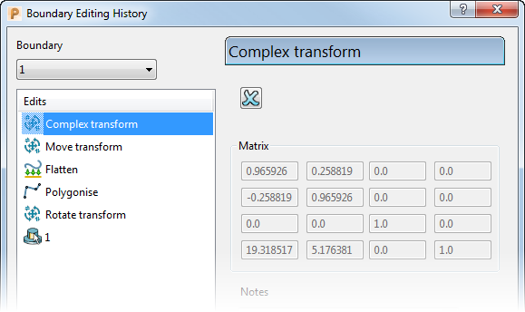

Additionally you can make complex edits which cannot be modified using the Boundary Editing History dialog, for example:
  1. From the individual boundary menu, select Edit > Transform. This displays the Boundary Transform tab.
  2. Click Boundary Transform tab > Transform panel > Move to display the Move toolbar.
  3. On the Move toolbar:
    1. Enter the coordinates 20 0 0 in the field on the status toolbar.
    2. Click to close the Move toolbar.
  4. Click Boundary Transform tab > Transform panel > Rotate to display the Rotate toolbar.
  5. On the Rotate toolbar:
    1. Enter an Angle of 15.
    2. Click to close the Rotate toolbar.
  6. Click Boundary Transform tab > Finish panel > Accept to accept the two transforms.
  7. From the individual boundary menu, select Edit > Boundary Editing History. This displays the two transforms as one complex transform.
    In this case, the matrix that combines the move and rotation but you cannot edit these values. You can delete this transformation by clicking .

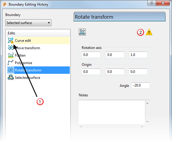

— When this icon is displayed, the boundary history contains one or more edits in which a curve segment or a point was selected. If the Edits list contains one or more of these selective edits, clicking Calculate only recalculates the boundary up to the first edit that required a selection and deletes all subsequent edits.
The selective edit.
Indicates that if you edit any values, you can re-calculate your boundary, but the history is not fully re-applied.

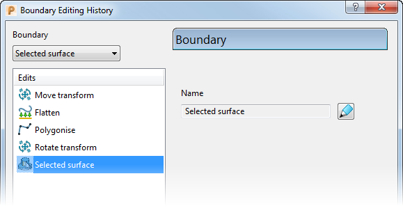

If you select the boundary, rather than an edit, the right side of the dialog displays the Boundary page.
  • Name — Displays the name of the boundary.
  • — Click to display the Boundary dialog. This is the same dialog that is displayed when you create or edit a boundary.
