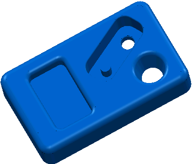

This example uses the Pockets.tri model in the Examples folder.

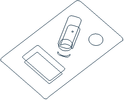

  3. Create a Shallow Boundary.

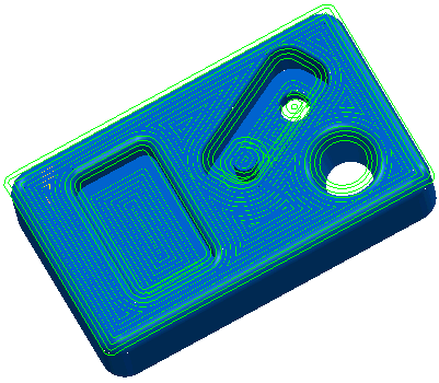

  4. Create a 3D Offset toolpath on the shallow areas:

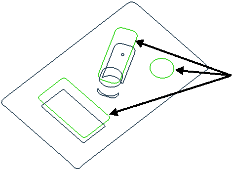

  5. Select the three boundary segments at the top of each pocket:

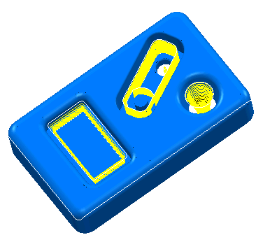

  6. Create a Constant Z toolpath.
Note: You can see that the constant Z toolpath has only been created inside the selected segments of the boundary.
