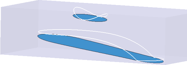

To create a surface plane at the lowest Boundary point
Use the Lower Plane item to create a surface plane that has the smallest maximum distance from the active Boundary and touches the Boundary at its lowest point.
To create a plane at the lowest Boundary point click Model tab > Create panel > Lower Plane.
