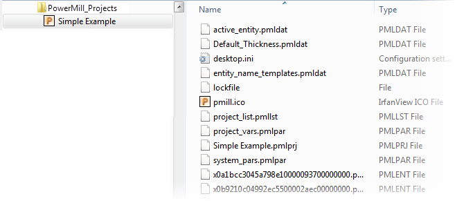

If you open the project folder in Windows Explorer, you can view the files that PowerMill has created:
Warning: Do not manually edit these files. Editing these files corrupts your data.
