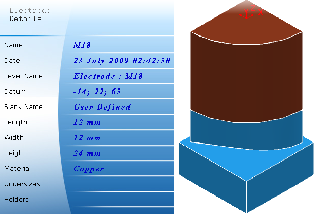

The electrode is imported with the HTML tab displaying the electrode details.
