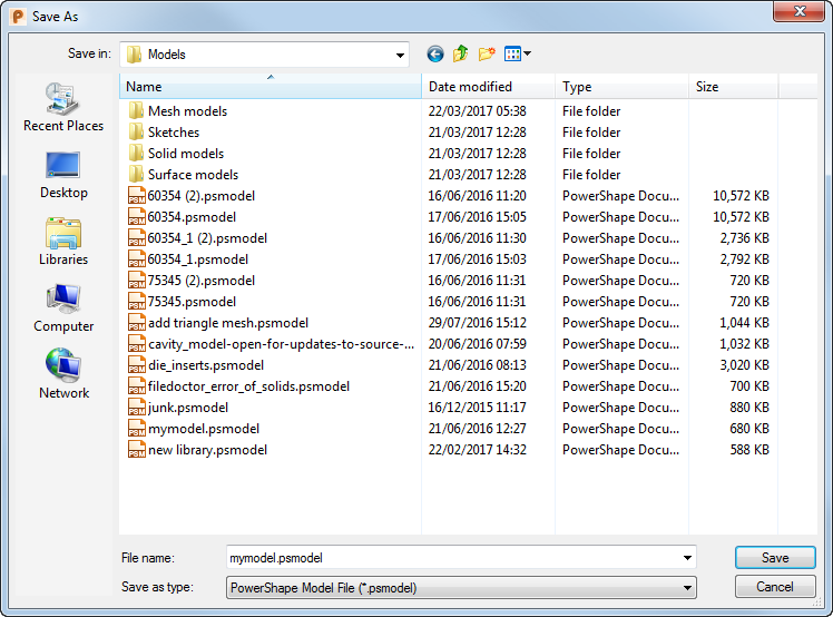

    To save the model as a file outside the shared database:
    1. Select File > Options > Application Options > File > Model.
    2. Select the Always save and open from outside the database option, and click OK.
    3. Click File > Save As. The Save As dialog is displayed.
    4. Use the Save As dialog to save your model under a new name.

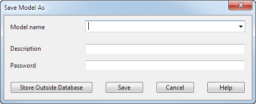

  • To save the model in the shareddb database:
    2. Deselect the Always save and open from outside the database option, and click OK.
    3. Click File > Save As. The Save Model As dialog is displayed:
    • In the Model name text box, type a name for the model.
      If the name is already in use, a warning message is displayed. If you continue, the existing model is overwritten.
      If you import files into a new model, the name of the last imported file is used as the model name when you save it. For example, if the name of the last file imported is handle.igs, the model name is handle.
    • In the Description box, enter a description to help identify the model and its contents.
    • Enter a Password if you want to protect the model from unauthorized access.
    • To store the model on the local disk or network, click Store Outside Database, and use the Save As dialog to specify its location and name.
      Alternatively, click Save to save the model in the default location.
