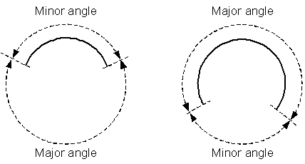

    • Arcs:
      The minor and major angles are the spans of the sector of the arc and the missing sector of the arc, as shown below:
      Position the cursor over the arc to display both the minor and major angles (the angle type not selected is shown in brackets):
      Click the arc to enter the value of the selected angle type into the Calculator dialog.

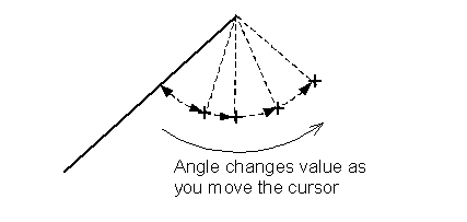

    • Between a line and a specified position:
      Select a line. A rubber-banded angle is displayed from the selected end of the line to the cursor. As you move the mouse cursor, the rubber-banded angle changes:
      Use this rubber-banded angle as a guide to determine the angle you want to measure.
      Click a position to enter the value of the selected angle type into the Calculator dialog.
      Note: The angle is calculated in the plane made by the two end points of the line and the position.

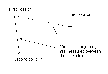

    • Using three positions:
      Specify three positions to define two lines, as shown below. The minor and major angles are measured between these two lines:
      When you click the first position, a rubber-banded angle is displayed from the position to the cursor. Use this as a guide, and select the second and third positions. The value of the selected angle is entered into the Calculator dialog when you click the third position.
